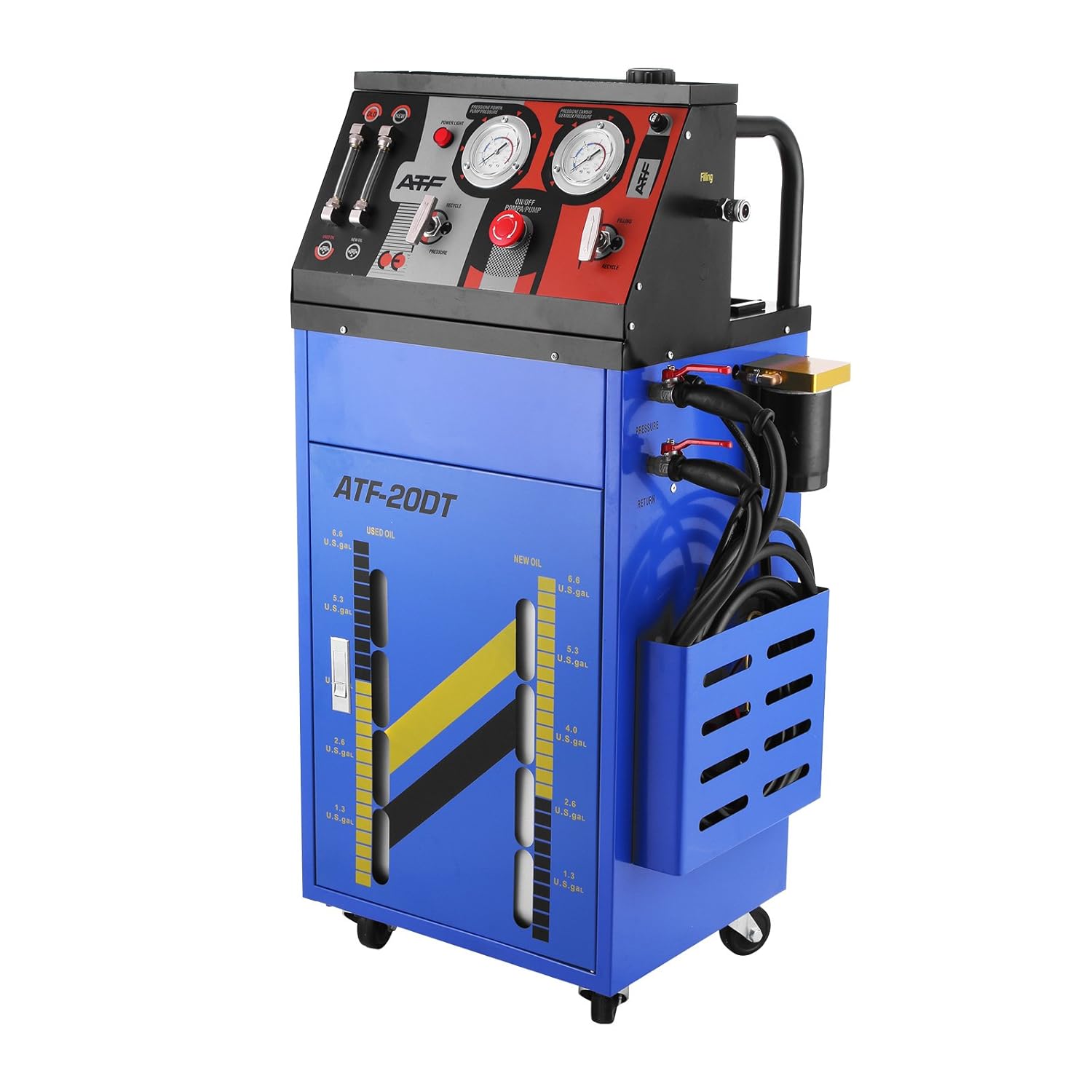

Fifty150 Posted June 5, 2018 Share Posted June 5, 2018 Most shops have a fluid exchange machine. @ $269, I am tempted to buy one. Shops will charge at least $150 for a transmission flush. 6 gallon capacity is 24 quarts. doitdub 1 Quote Link to comment Share on other sites More sharing options...
