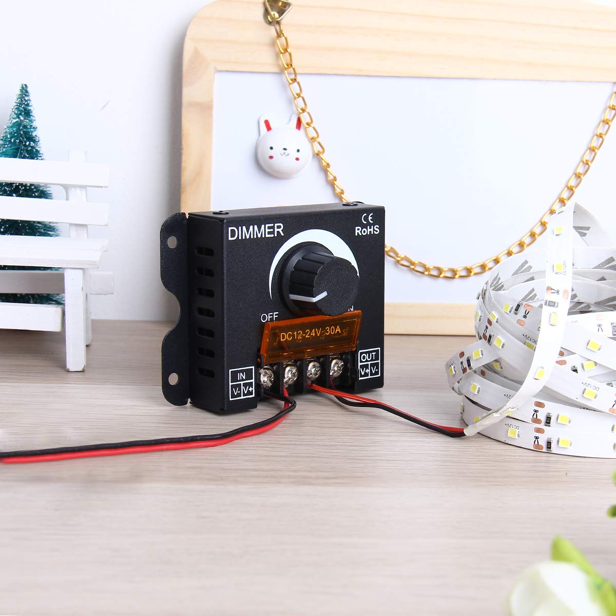

Chococar Posted April 15, 2021 Author Share Posted April 15, 2021 It works! The PWM dimmer I bought on Amazon works great. It's simple to wire electrically (2 wires in, 2 wires out). In case anyone is interested, this is the one that I bought: https://www.amazon.com/gp/product/B07HN1BJWK/ref=ppx_yo_dt_b_asin_title_o01_s00?ie=UTF8&psc=1. It seems to be sold under many brand names... So now I'm going to buy some more of these LED lights and use them in other places in the van, all running off the leisure battery. First place to add one will be in the matching hole on the opposite of the van. Quote Link to comment Share on other sites More sharing options...

Chococar Posted April 16, 2021 Author Share Posted April 16, 2021 Full range of dimming. Quote Link to comment Share on other sites More sharing options...
