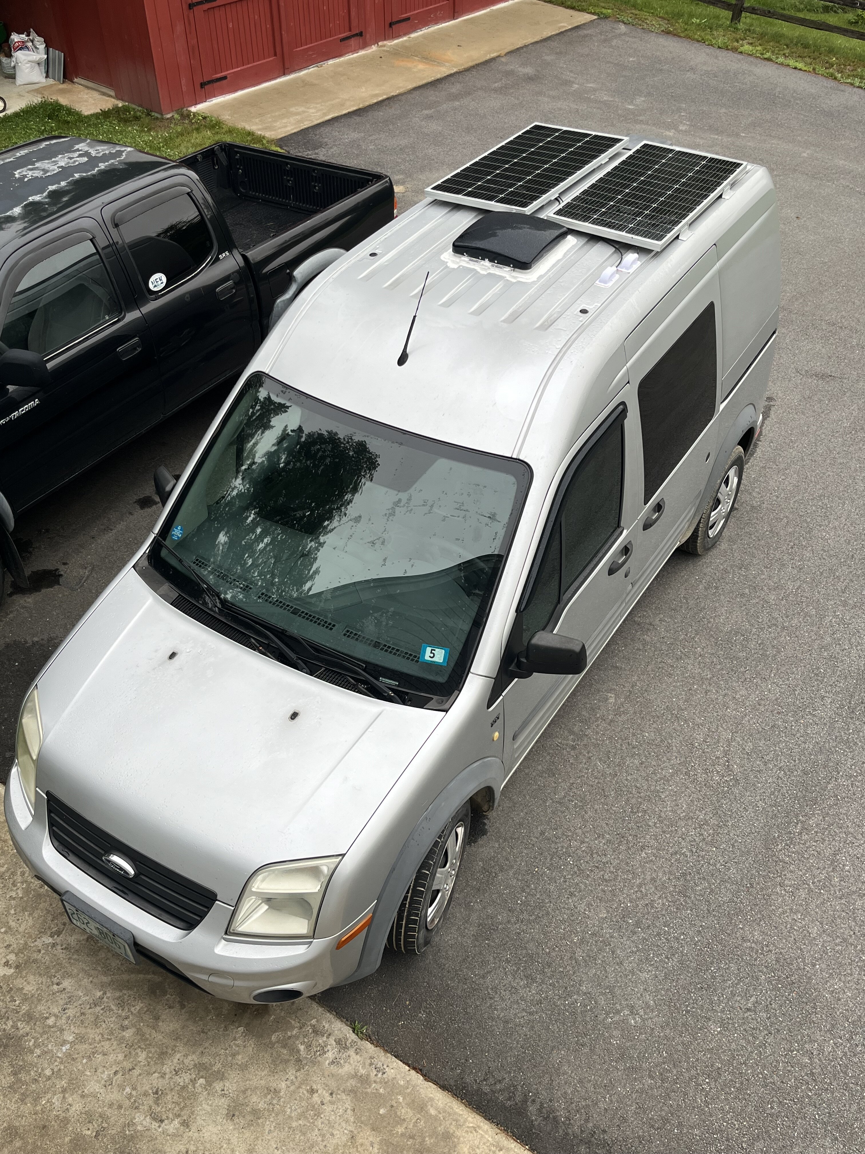

I’m almost done but for the last electrical work. I’m now working nearly full time so my van work needs to fit into much less free time. I’ve installed the roof vent and the solar panels and I’m working on the battery tray for the 100Ah LiFePO4 group 24 battery. The solar controller and a couple for cut off switches are installed but not wired as well as a fuse box, a switch panel and the wiring between them. I’m happy everything seems to fit on such a small roof too.
