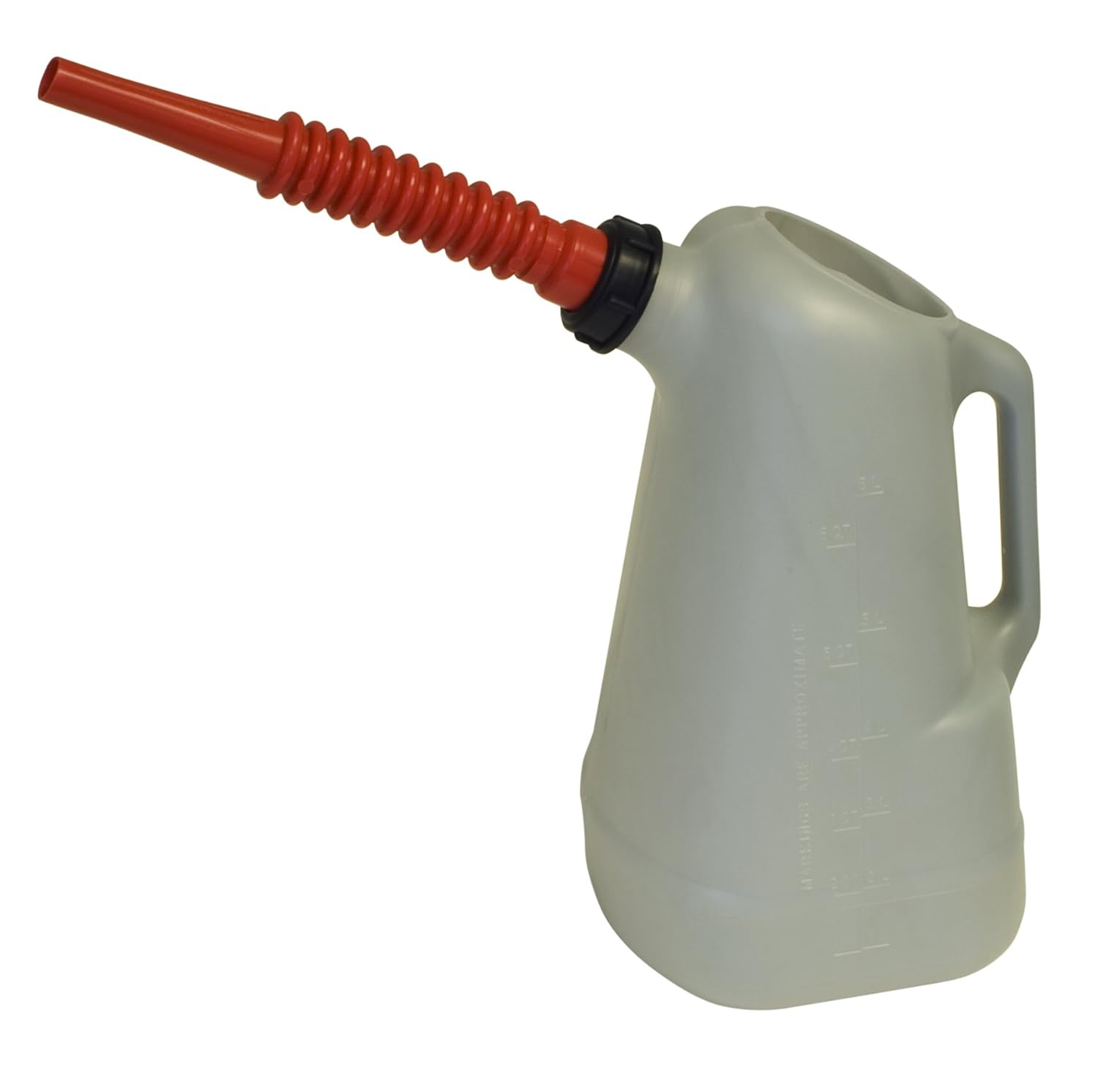

I started buying ATF & motor oil in 6 gallon "bag in a box" enviro-packs.  Dilemma was transferring fluid from container to vehicle.  Bag-In-A-Box has a spout, so it's just like boxed wine.  My solution was to buy dispenser bottles.  Measurement marks on both sides for quarts and liters.  Flexible pour spout.  I attach a 3/4" ID, 1" OD length of vinyl tubing to the end of the spout.  This allows me to insert the tube into the engine or transmission.  No more funnels.  I found these items on Amazon for a significantly lower price than my local stores.
Lisle 19752 Red Oil Dispenser - 6 Quart Capacity
https://smile.amazon.com/gp/product/B005ETVOP2/ref=ppx_yo_dt_b_asin_image_o00_s00?ie=UTF8&psc=1
3/4" ID Low Pressure Clear Flexible PVC Tubing
https://smile.amazon.com/gp/offer-listing/B00LX6MIV4/ref=dp_olp_new_mbc?ie=UTF8&condition=new
