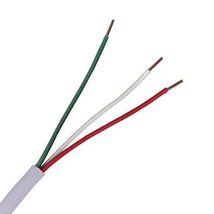

Here is a view of my wire going into the void next to the door hinge.  I am using 3 wires because my lighting is set up that way.  You should be using 2 wires, for power and ground.
