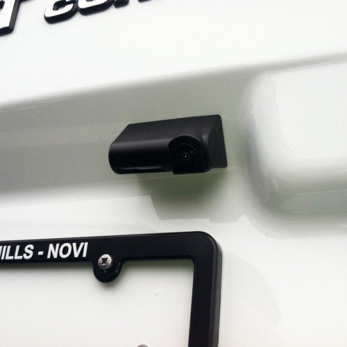

What is the "OEM-look" that you're looking for?  I noticed that the OEM camera, on both the van & wagon, are not mounted at the center of the vehicle.  I guess it wouldn't matter much.
It looks like this camera would work fairly well alongside the license lamp of the liftgate on the wagon model.  Just mount it to the right of the lamp as the OEM camera is situated.

I mean like the Mk1 number plate light camera. No extra drilling, just swap out the plate light.

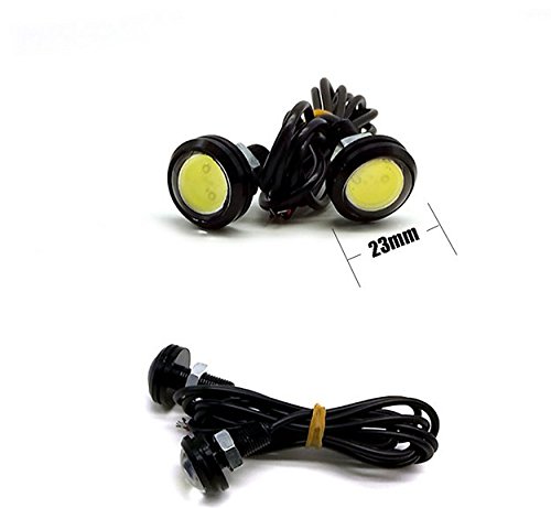

RioRand® 4pcs 23mm DC 12V 1.5W COB LED Eagle Eye Car White Light Lamp Daytime Running Light DRL Fog Light Headlight RR-315394
by RioRand
List Price: $15.99
Price: $9.95 Free Shipping for Prime Members
You Save: $6.04 (38%)
A lot of cursing, and a 12 pack of beer later.
Okay, so the aux white led is just an additional light for the camera?
At the moment, it's triggered by the reverse lamp.  I have tinted windows, so it helps when I turn my head and look over my shoulder.  I suppose that if I wanted, I could wire as many of those little lamps as I want, on any part of the car, and wire them to a toggle switch.  Or I could wire them in tandem with the interior lights ad mount them under the edge of the vehicle, so that the ground around the floor lights up when the doors open.
